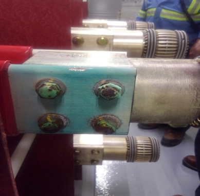

Photo 1. New 35kV indoor switchgear was damaged by partial discharge because of inadequate heaters, high moisture levels, and insufficient clearances.

A new 35kV indoor switchgear was damaged by partial discharge as a result of inadequate heaters, high moisture levels, and insufficient clearances (Photo 1). In Photos 2 and 3, you can see signs of partial discharge on the inside of the receiver bottle. This damage aligns with the bolt head/nut from the breaker stab. Photo 4 shows a switchgear insulating barrier board with tracking and deterioration from partial discharge activity.

Many of the issues depicted in Photos 1 through 6 were detected during the visual inspection phase of online testing and maintenance activities. But online testing can also reveal underlying issues that cannot be detected during normal visual assessment. For example, the thermographic image of a transformer in Photo 7 shows abnormal heating. This image indicates there may be a connection issue or issues with the fluid and fluid level. Photo 8 shows overheating due to inadequate connections and failing fuses.
