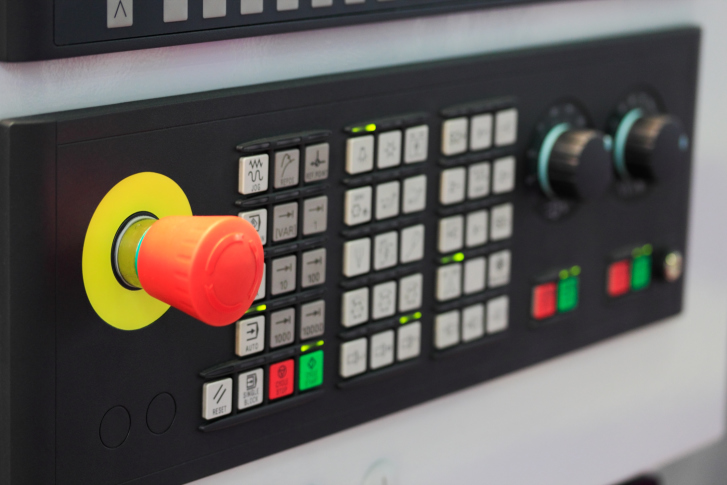

Let’s say it’s a hydraulic press. These always have a light curtain, deadman switch, or other protective device. That’s a likely point of failure if the thing won’t start. Similarly, a conveyor system always has at least one emergency stop (E-stop) switch unless the management is safety-averse.
Similar to the safety device is the “permissive” device. It gives the system permission to start. This can be a limit switch (e.g., drain valve closed), temperature switch, pressure switch or other device whose contacts must be in the OK position (usually, that’s closed) for the system to start. You may need the system drawings to find it.
