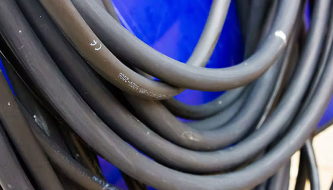

Cords are important enough that OSHA puts separate emphasis on them. For example, it refers to “flexible cords and cables” [1926.405(g)] and states a requirement for how “Type SJ, SJO, SJT, SJTO, S,SO, ST, STO cords” must be marked [1926.405(g)(2)(ii)]. Following that, it provides splicing [1926.405(g)(2)(iii)] and strain relief requirements [1926.405(g)(2)(iv)] for cords.
Thermo what?
Most cord jackets are composed of one or more of these three compounds: thermoset, thermoplastic, and thermoplastic elastomer.
  • Thermoset jackets are heavy-duty grade or specification-grade rubber. Cords made from thermoset are flexible, even in extreme cold. These cords also have much higher melting temperatures than their plastic counterparts. They are noticeably heavier than the other types of cords.
  • Thermoplastic is a light-duty plastic compound. Cords made from thermoplastic are suitable for light-duty use.
  • Thermoplastic elastomer is a medium-duty plastic that is lighter than thermoset. For most jobs, thermoplastic is a good choice because it gives high performance with a relatively low weight. However, it can’t withstand the extremes that thermoset can.
