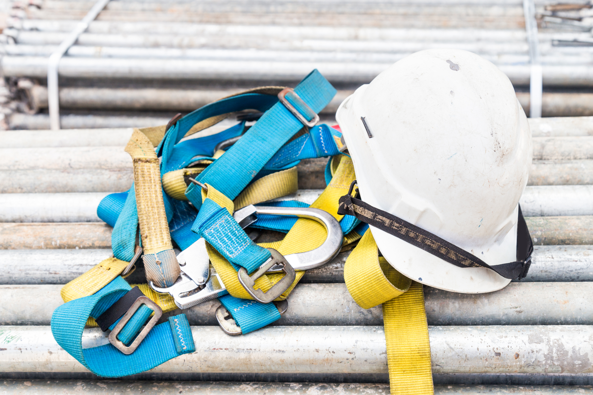

A visual inspection doesn’t confirm whether your safety harness is actually safe.
The fall protection program in many companies is woefully out of touch with the reality of materials and physics. Often, it consists of the user performing a perfunctory visual inspection and a “feel test” for defects such as frayed stitches. Yes, this step is important but it alone is insufficient. A harness that looks perfectly good might not be able to hold you if you fall.
It might seem to make sense to use a harness until it has only one use left in it. But there is no reliable way to tell if that one last use will be a safe catch — or if it will be one last use because the harness failed and you took a lethal fall to the ground.
