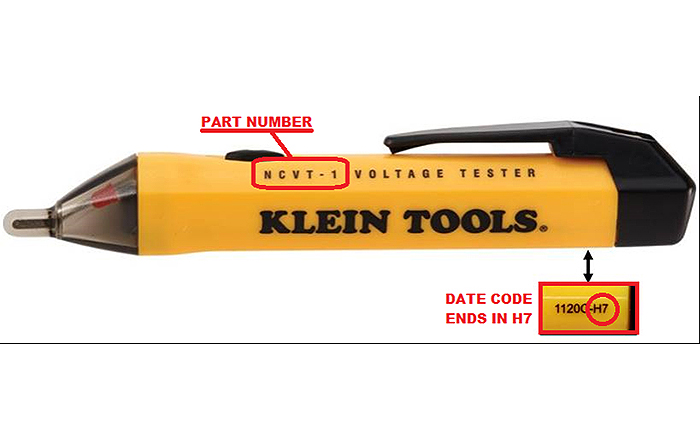

The on/off button can remain depressed during the power on or power off cycle, causing the tester to work improperly
Klein Tools has issued a recall of its non-contact voltage testers with model numbers NCVT1 and date codes ending H7.
The company says that the on/off button can remain depressed during the power on or power off cycle, causing the tester to work improperly. Users testing electrical sources could fail to be warned of the presence of live voltage if the tester is not properly operating, posing a shock hazard. The recall includes approximately 1,690,000 units in the United States and 67,800 sold in Canada.
The meters have a yellow body housing with a tinted gray tip and feature a black pocket clip/battery cap on the back. The part/model numbers are written on the top of each unit above the brand name KLEIN TOOLS, and date codes are printed on the bottom of the unit under the brand name. The product is rated CAT IV and measures voltage up to 1,000V.
