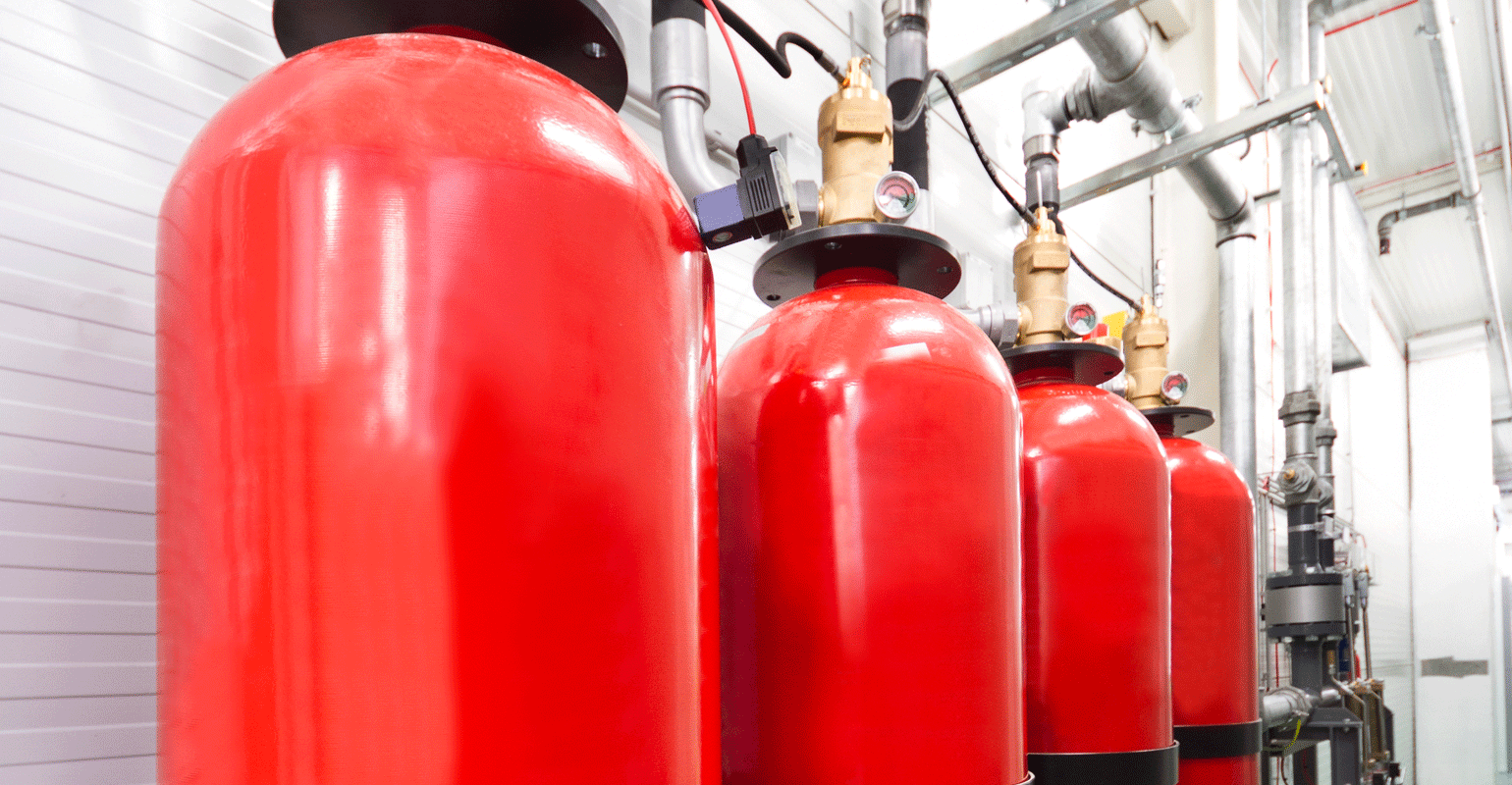

An FSPR can be anything from a large backup generator room to a closet-sized space that is part of process equipment. If you don’t know what type of system the FSPR has, assume it uses a gas to smother the fire (and, potentially, you) until you can verify otherwise.
Numerous types of fire suppression systems are in use today (kisgorcs/iStock/ Getty Images Plus).
