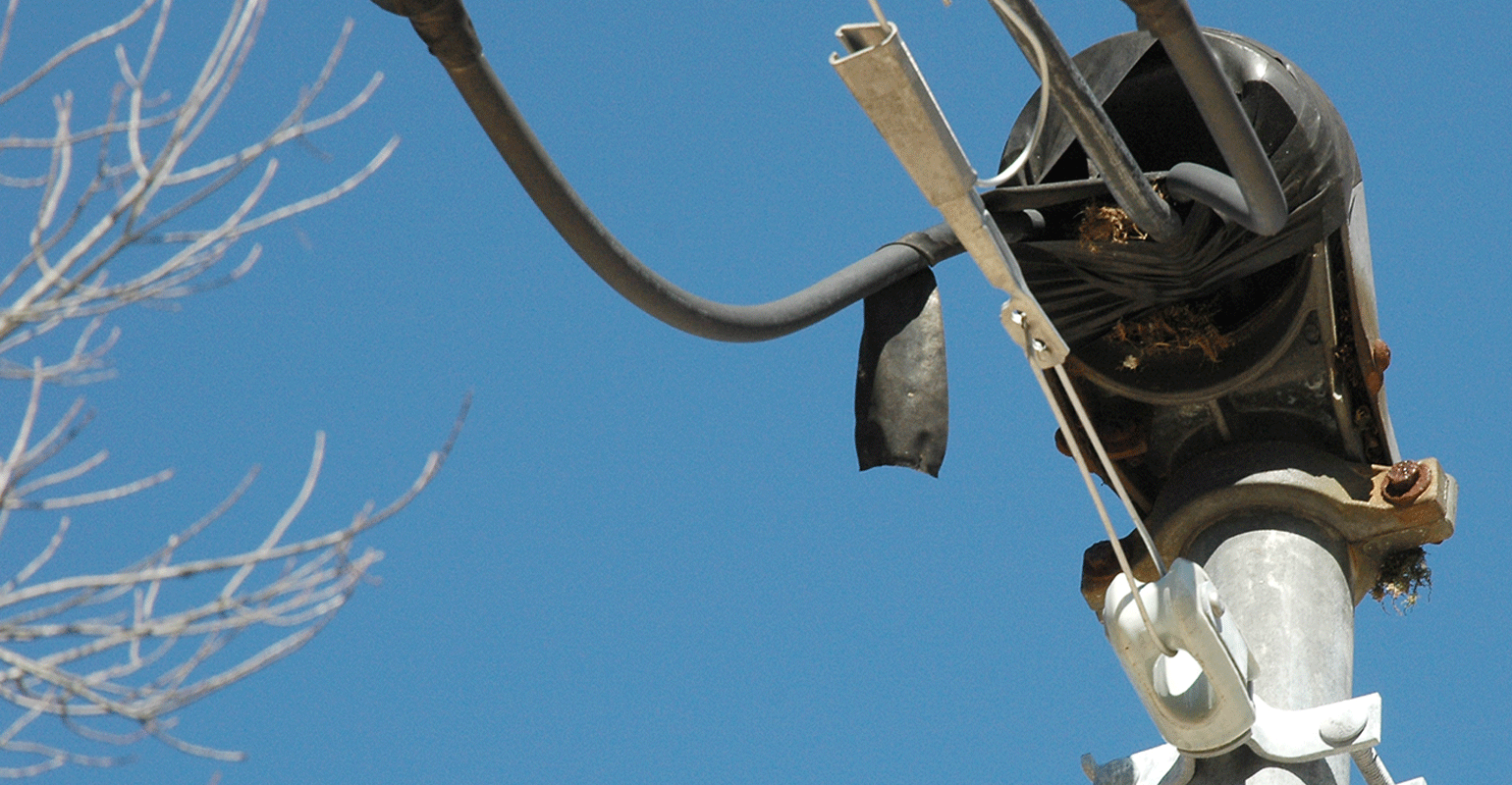

It didn’t take long to figure out that the neutral was damaged or open by taking some measurements and hearing about the “gremlin-like” happenings. We soon noticed the messenger cable (i.e., service neutral) at the service mast was broken (Photo 2).
Photo 2. The service neutral at the weatherhead had broken apart.
I called the electric utility and asked it to send out a crew and repair the damaged messenger cable. While waiting for them to arrive, I began to check the charred log siding. The TV cable entered the home and ran up the side of the house in the charred section. The coax was melted and burned (Photo 3).

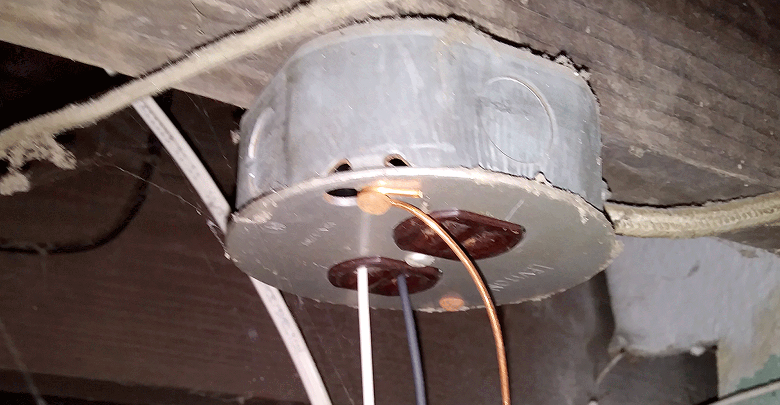

Further evaluation revealed that the original and only grounding electrode for the home was an underground galvanized water pipe. The pipe was abandoned due to low flow a few years back and was replaced with PEX pipe. Although the metal pipe was still present, the plumber (or someone… I always like to blame plumbers) apparently felt the grounding electrode conductor (GEC) was no longer needed, so he disconnected it from the pipe (Photo 4). Now, with the main neutral feeder open, the only available return path for the neutral current was on the coax grounded shield. And with no grounding connection at the house, the first point of grounding for the coax was at the electric utility pole some 250 ft from the house. (Note: The lack of a grounding electrode in this situation most likely had little effect, and the result would have been the same.)
Photo 4. When the galvanized water pipe was replaced with PEX, the original GEC was disconnected.
