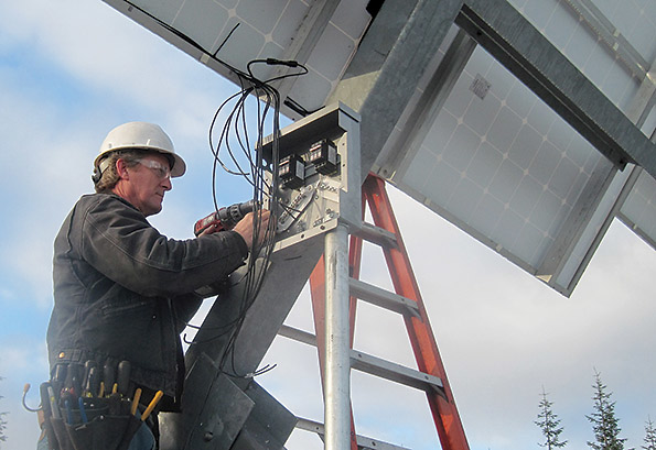

Photo courtesy of Willpower Electric, LLC

Willpower Electric, LLC, a Medford, Ore.-based electrical contracting and solar firm, installs stand-alone and grid-tied power systems and hybrid renewable energy systems. The North American Board of Certified Energy Practitioners (NABSEP) certified the company’s president, Bruce Fiero, as a certified PV solar installer (Photo courtesy of Willpower Electric, LLC).
