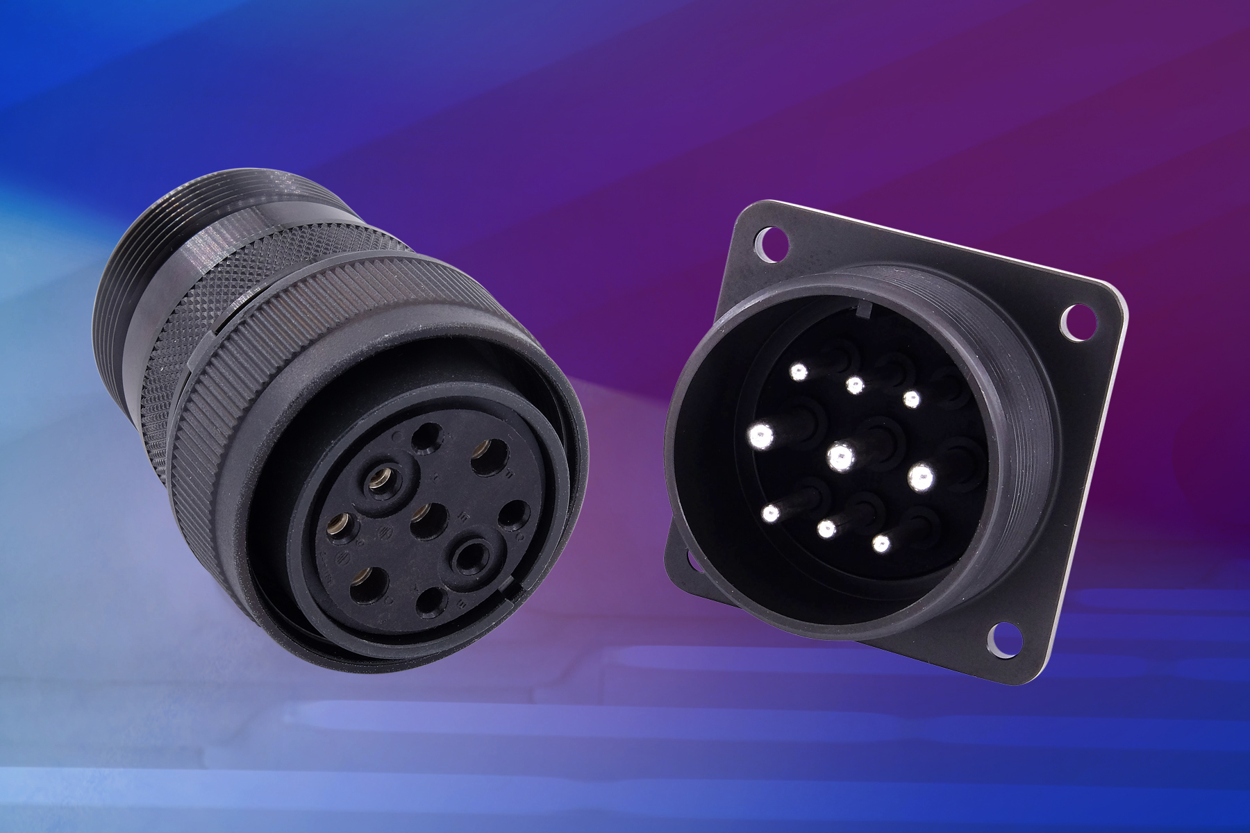

The product includes a receptacle with IP67 protection when unmated and a plug when mated.
Amphenol Industrial Operations has enhanced its Pre-Earth FMLB connectors. Designed to meet the safety requirements for applications where a protective circuit from the ground to the shell is needed, features include a receptacle with IP67 protection when unmated and plug when mated for greater moisture sealing and waterproofing; conformity with European safety standards of DIN VDE 0627; SAE AS50151 dimensions and performance; as well as being intermateable with MS 5015 and 97 Series styles. The connector also meets the IEC/EN 61984 standard. In addition, the product offers different shell sizes, including 3102A box mount and 3106A straight plug. Other highlights include an operating temperature range from -55˚C to 125˚C; the ability to withstand up to 100 mating cycles; contact sizes from 4 to 20 with silver and gold plating available; either soldering or optional crimp terminations; current ratings from 5A to 80A; and voltage ratings of 110VAC, 150VAC, 200VAC, 250VAC, 400VAC, and 500VAC.
