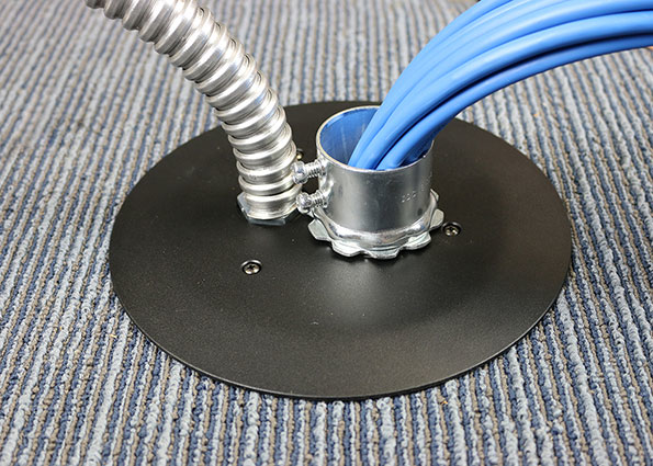

¾-in. opening for power and 1½-in. opening for communication cabling Installs on tile, carpet, or wood-covered concrete floors Built-in TopGuard protection
The Wiremold 4FFATC15 Series furniture feed poke-thru device is designed to feed power, communication, and audio/video services to modular furniture systems in an open-space, above-grade environment. Featuring a ¾-in. (19-mm) opening for power and a larger 1½-in. (38-mm) opening for communication cabling, the poke-thru can be installed on tile, carpet, or wood-covered concrete floors in new or retrofit construction. In addition, the UL-listed device features built-in TopGuard protection to prevent water, dirt, and debris from entering power and communication compartments.
