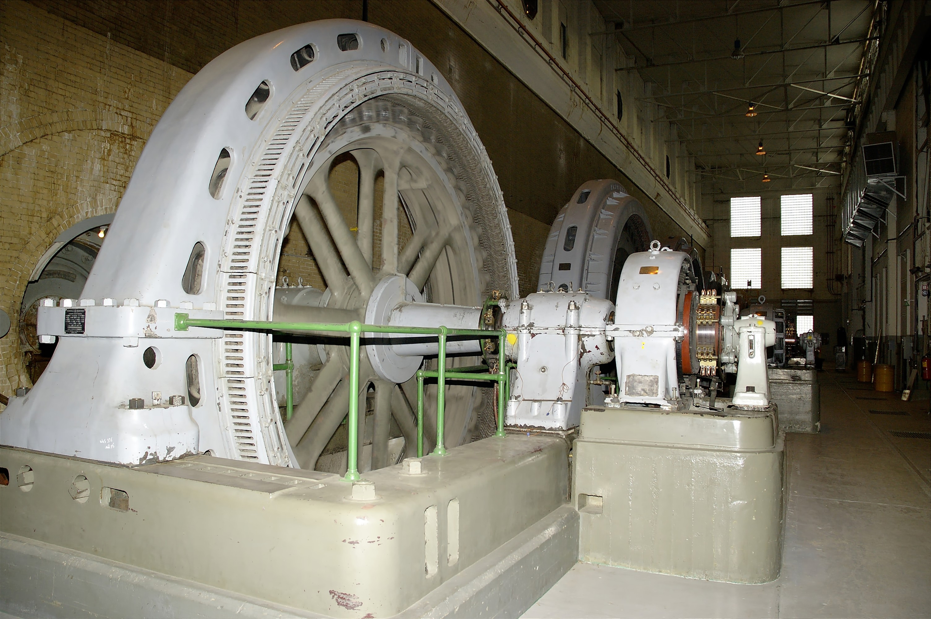

© Alan Heartfield - Dreamstime.com
Old Power Generator Alan Heartfield Dreamstime Xxl 84249 5e95cec520709
