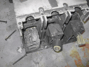

Under normal conditions, capacitors should operate trouble-free for many years. However, conditions such as harmonic currents, high ambient temperatures, and poor ventilation can cause premature failures in power factor correction capacitors and related circuitry. These failures can lead to substantial increases in energy expenses and — in extreme cases — create the potential for fires or explosion (Photo 1). Therefore, it’s critical to inspect power factor correction capacitors on a regular basis to ensure they’re working properly. In fact, most manufacturers recommend that preventive maintenance be performed twice a year.
