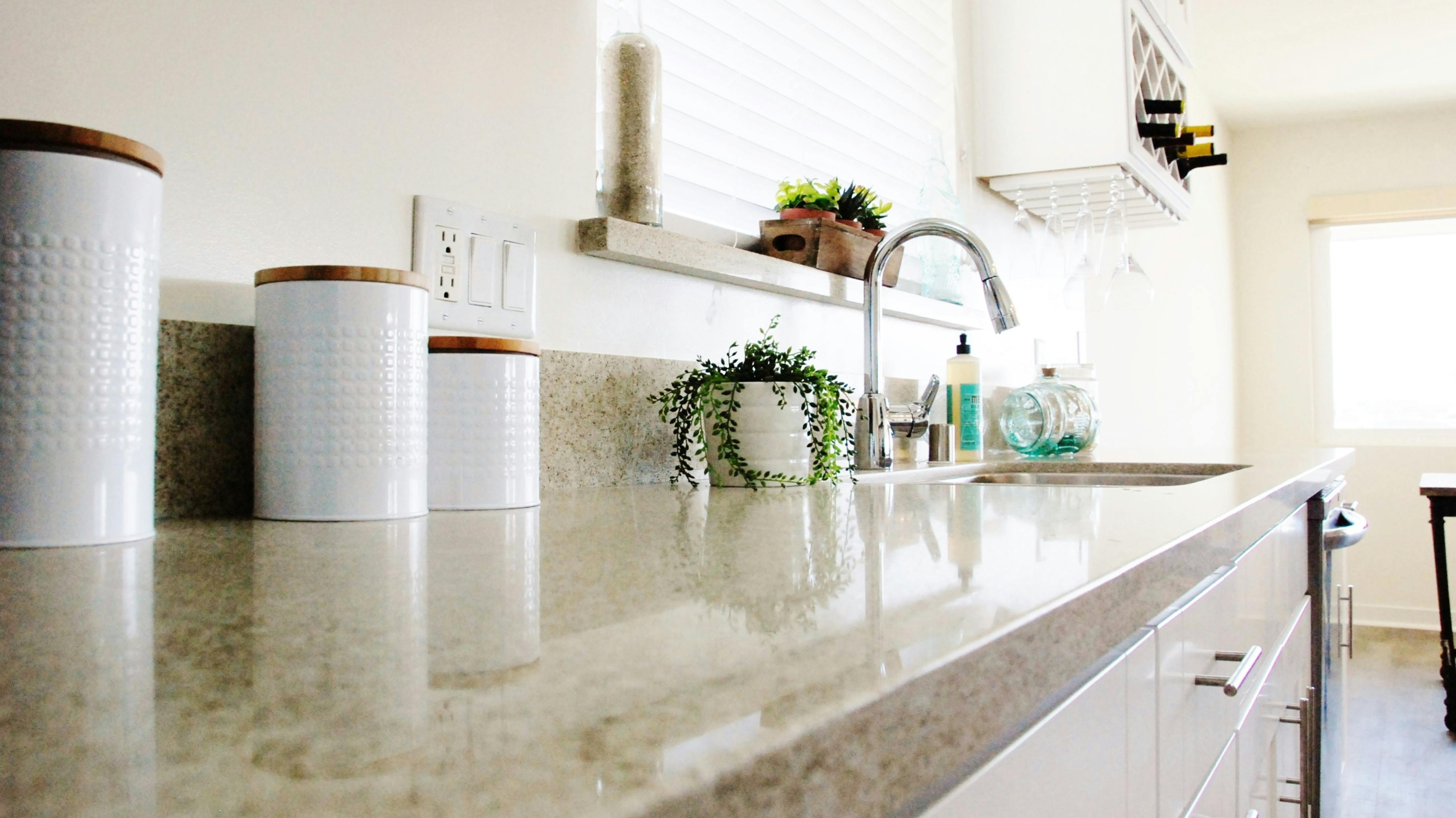

Q1: Kitchen wall countertop and work surface space receptacle outlets shall be installed so that no point along the wall line is more than _____ measured horizontally from a receptacle outlet in that space.
a) 10 in.
b) 12 in.
c) 18 in.
d) 24 in.

Q1: d) 24 in.
Per Sec. 210.52(C)(1): "Receptacle outlets shall be installed so that no point along the wall line is more than 24 in. measured horizontally from a receptacle outlet in that space."
