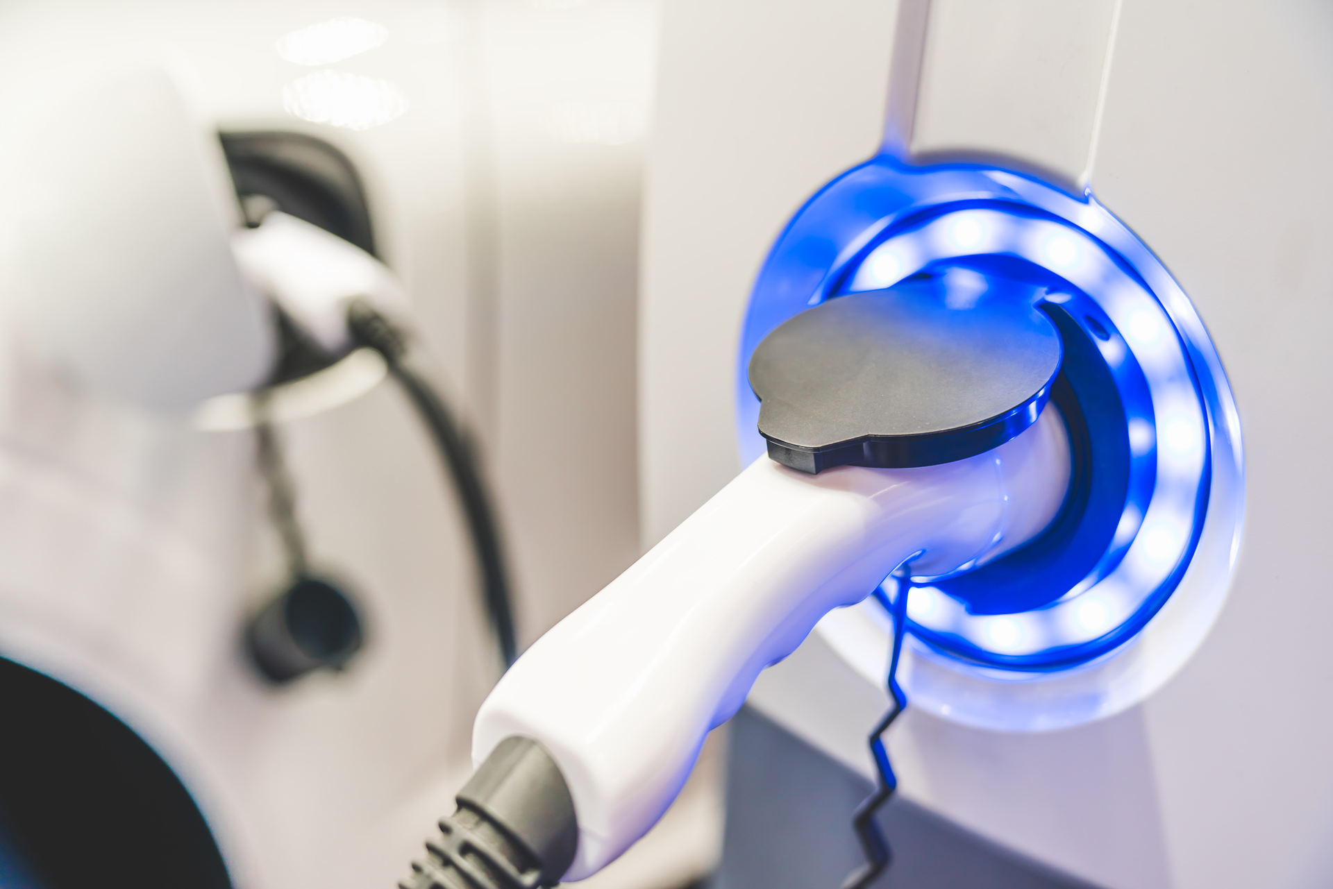

Code Quiz: Wiring Requirements for EV Charging Equipment
Feb. 18, 2021
Test your Code knowledge.
Based on the 2020 NEC.
Question: Does a receptacle outlet for electric vehicle charging equipment require GFCI protection?
 See answer below.
Answer: Yes
Explanation: New language in Sec. 625.54 of the 2020 NEC requires GFCI protection for ALL receptacles used for electric vehicle charging equipment.
