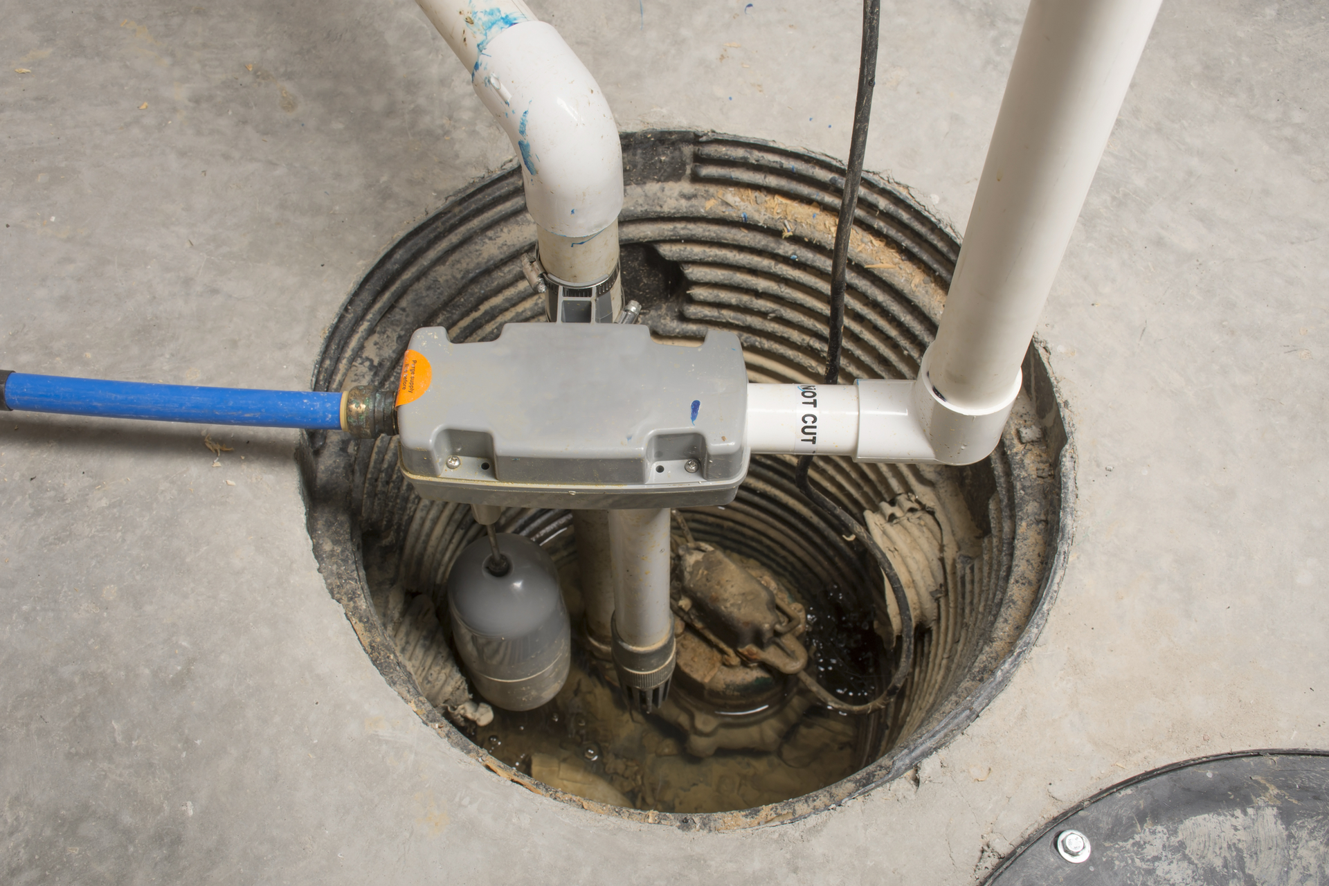

Code Quiz: Protecting a Sump Pump
Feb. 4, 2021
Test your Code knowledge.
Based on the 2020 NEC.
Question: Does a 20A, 120V single receptacle supplying a permanently installed sump pump require GFCI protection?
See answer below.
Answer: Yes
Explanation: A change in Sec. 620.6 of the 2020 NEC requires a permanently installed sump pump to be either connected to a GFCI protected single receptacle or hardwired.
