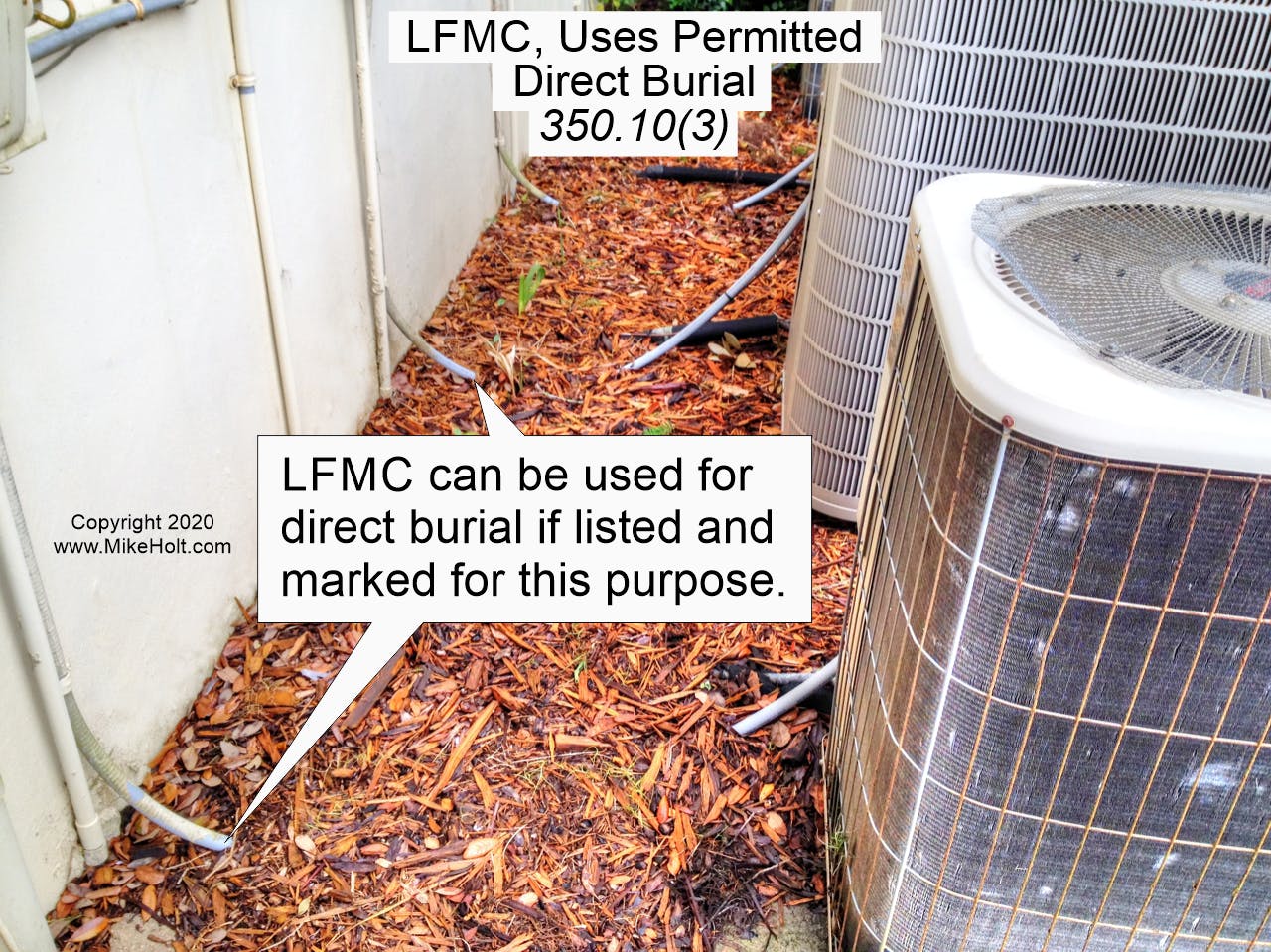

(3)For direct burial if listed and marked for this purpose (see the Fhoto below).
