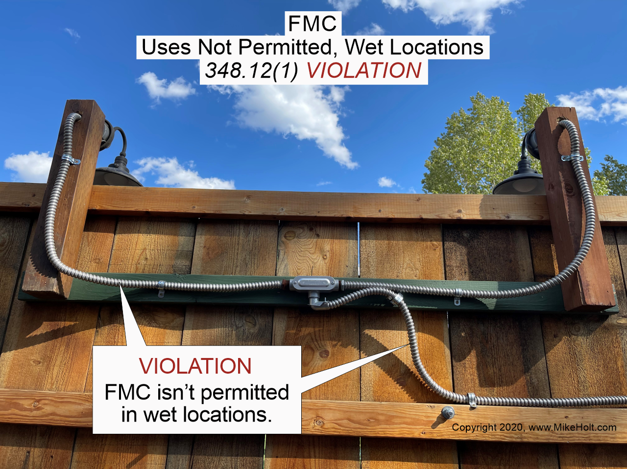

Q.  Under what conditions can FMC not be used and installed?
See answer below.
A.  The conditions where FMC can not be used are found in Sec. 348.12.
FMC is not permitted:
(1)  In wet locations (Fig).
(2)  In hoistways, other than as permitted in Sec. 620.21(A)(1).
(3)  In storage battery rooms.
(4)  In any hazardous (classified) location, except as permitted by Sec. 501.10(B).
(5)  Exposed to material having a deteriorating effect on the installed conductors.
(6)  Underground or embedded in poured concrete.
(7)  Where subject to physical damage.
