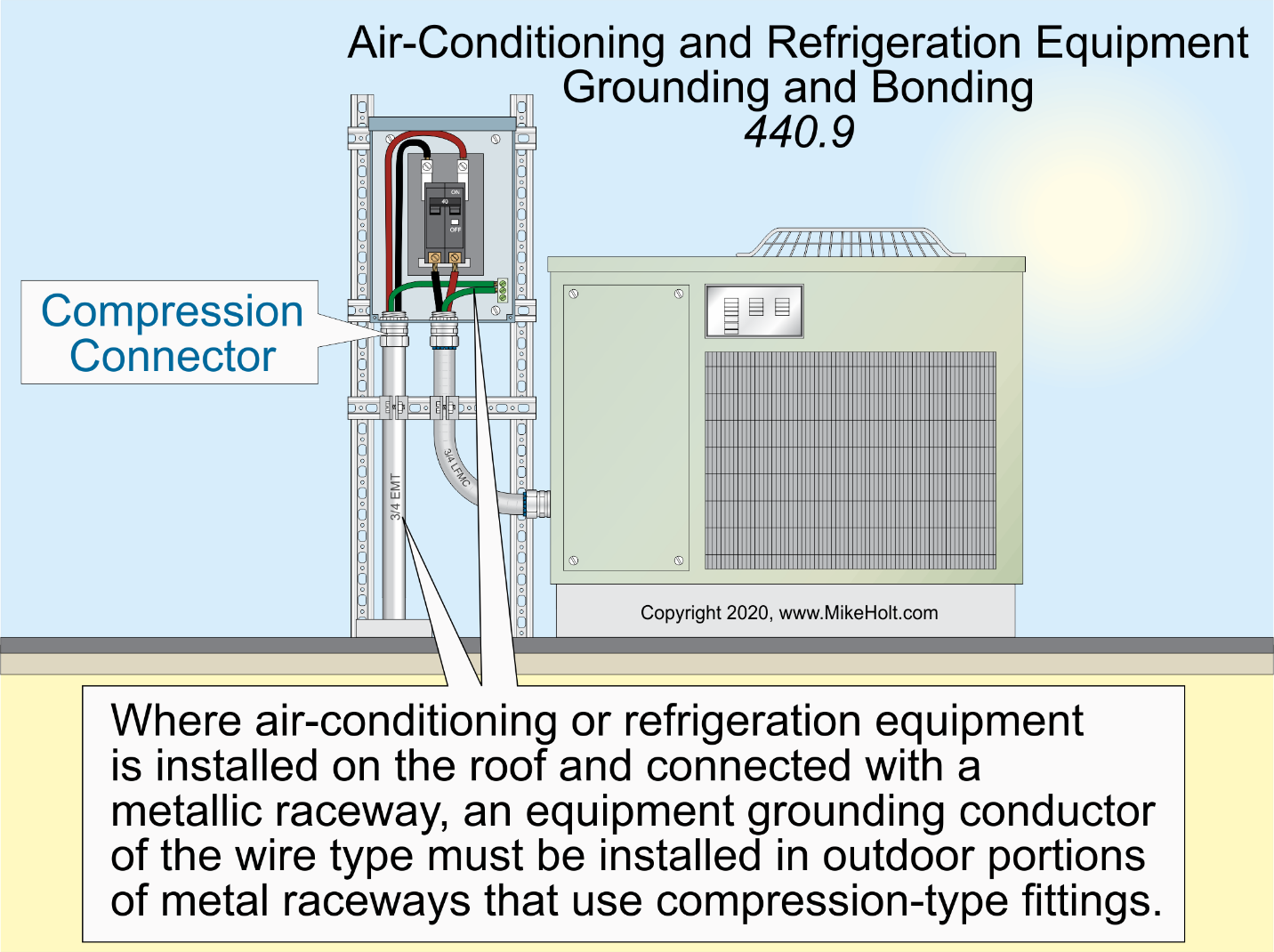

Q. When does the NEC require an equipment grounding conductor of the wire type for air-conditioning or refrigeration equipment installed on the roof and connected through a metallic raceway?
See answer below.
A. Where air-conditioning or refrigeration equipment is installed on the roof and connected with a metallic raceway, an equipment grounding conductor (EGC) of the wire type must be installed within outdoor portions of metallic raceway systems that use compression-type fittings [Sec. 440.9]. 
The outdoor portions of rooftop metallic raceways with compression fittings are exposed to a higher likelihood of physical damage and often left stepped on and unbroken from roof activities such as snow removal or a roof repair/replacement. The installation of the EGC of the wire type within the outdoor portions of metal raceways provides reassurance of the effective ground-fault current path.
