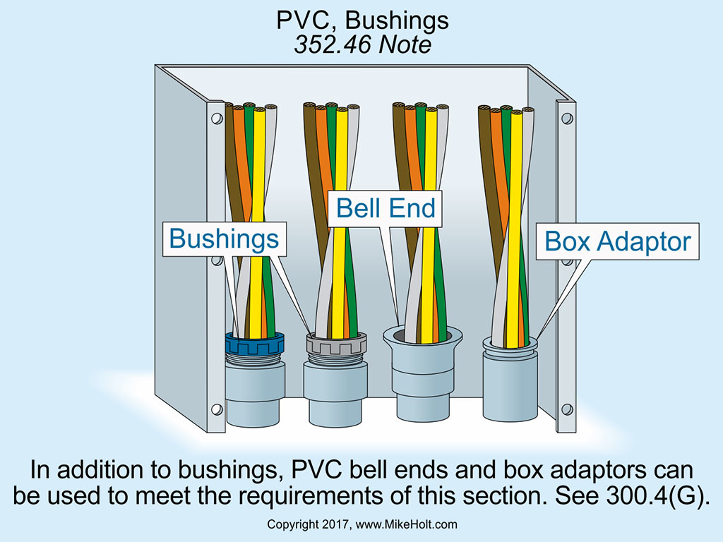

Q. What is the NEC rule for the installation of bushings on PVC conduit terminations?
See the answer below.
A. Where PVC enters a box, fitting, or other enclosure, conductors 4 AWG and larger must be protected from abrasion, during and after installation, by a fitting that provides a smooth, rounded insulating surface [Sec. 300.4(G) and Sec. 352.46].
Informational Note: Conductors 4 AWG and larger that enter an enclosure must be protected from abrasion, during and after installation, by a fitting that provides a smooth, rounded insulating surface, such as an insulating bushing, unless the design of the box, fitting, or enclosure provides equivalent protection, in accordance with Sec. 300.4(G).
When PVC conduit is stubbed into an open-bottom switchboard, the raceway, including the end fitting (bell-end), must not rise more than 3 in. above the bottom of the switchboard enclosure [Sec. 300.16(B) and Sec. 408.5].
