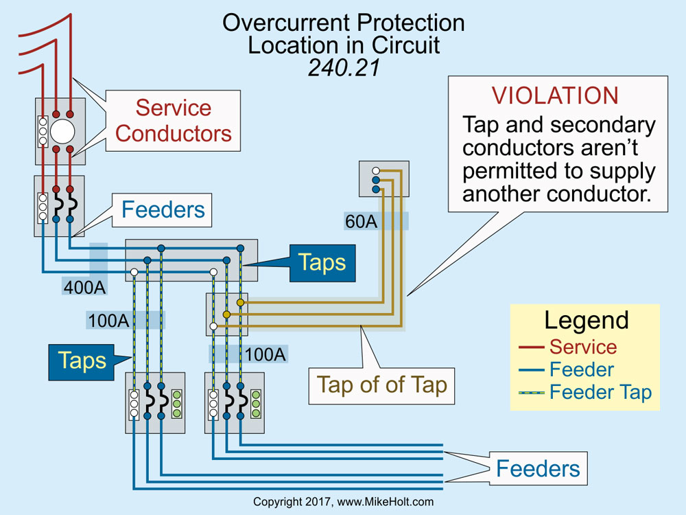

Q. Per the NEC, overcurrent protection devices must be placed at what location in branch-circuit or feeder conductors?
A. Except as permitted by Sec. 240.21(A) through (H), overcurrent protection devices must be placed at the point where the branch-circuit or feeder conductors receive their power. Taps and transformer secondary conductors aren’t permitted to supply another conductor (tapping a tap isn’t permitted) [240.21], as shown in the Figure.
Branch-circuit tap conductors are permitted in accordance with Sec. 210.19, and can have overcurrent protection as required by Sec. 210.20 [240.21(A)].
Conductors can be tapped from a feeder (feeder taps) as specified in Sec. 240.21(B)(1) through (B)(5). The “next size up overcurrent protection rule” of Sec. 240.4(B) isn’t permitted for tap conductors [240.21(B)].

Let’s run through an example problem to drive this point home.
Example: A 400A breaker protects a set of 500kcmil feeder conductors. There are three taps fed from the 500kcmil feeder that supply disconnects with 200A, 150A, and 30A overcurrent protection devices. What are the minimum size conductors for these taps?
Answer:
• 200A Disconnect Tap: 3/0 AWG is rated 200A at 75°C and is greater than 10% of the rating of the overcurrent protection device (400A).
• 150A Disconnect Tap: 1/0 AWG is rated 150A at 75°C and is greater than 10% of the rating of the overcurrent protection device (400A).
• 30A Disconnect Tap: 8 AWG rated 40A at 60°C. The tap conductors from the 400A feeder to the 30A overcurrent protection device can’t be less than 40A (10% of the rating of the 400A feeder overcurrent protection device).
