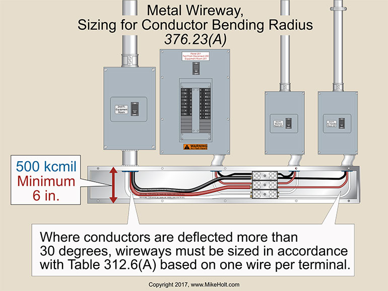

What is the Code bending radius requirement for conductors installed in a metal wireway?
Q. What is the Code bending radius requirement for conductors installed in a metal wireway?
See the answer below.
This answer is based on the 2017 NEC.
A. Where conductors are bent within a metal wireway, the wireway must be sized to meet the conductor bending space requirements outlined in Table 312.6(A), based on one wire per terminal [Sec. 376.23(A)].
