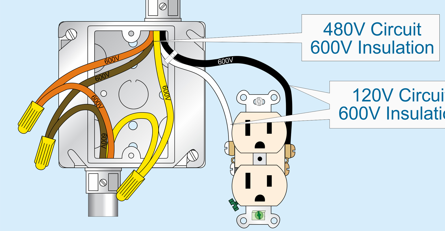

Rules for working with conductors of different systems [Sec. 300.3(C)]:
(1) Mixing. Power conductors of AC and DC systems rated 1,000V or less can occupy the same raceway, cable, or enclosure if all conductors have an insulation voltage rating not less than the maximum circuit voltage (Figure). 

Class 1 circuit conductors can be installed with associated power conductors [Sec. 725.48(B)(1)] if all conductors have an insulation voltage rating not less than the maximum circuit voltage [Sec. 300.3(C)(1)].
A Class 2 circuit that’s been reclassified as a Class 1 circuit [Sec. 725.130(A), Exception No. 2] can be installed with associated power conductors [Sec. 725.48(B)(1)] if all conductors have an insulation voltage rating not less than the maximum circuit voltage [Sec. 300.3(C)(1)].
