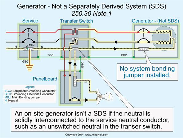

Q. When is an on-site generator not a separately derived system?
A. An alternating-current power source such as an on-site generator isn’t a separately derived system if the neutral conductor is solidly interconnected to a service-supplied system neutral conductor. An example is a generator provided with a transfer switch that includes a neutral conductor that’s not switched [250.30 Note 1], as shown in Fig. 2.
Fig. 2. See Art. 100 for a definition of a separately derived system.
According to Art. 100, a separately derived system is a wiring system whose power is derived from a source, other than a utility, where there’s no direct electrical connection to the supply conductors of another system, other than through grounding and bonding connections.
Transformers are separately derived when the primary conductors have no direct electrical connection from circuit conductors of one system to circuit conductors of another system, other than connections through grounding and bonding connections.
A generator having transfer equipment that switches the neutral conductor, or one that has no neutral conductor at all, is a separately derived system and must be grounded and bonded in accordance with Sec. 250.30(A).
For non-separately derived systems, see Sec. 445.13 for the minimum size neutral conductors necessary to carry fault current [250.30 Note 2].
