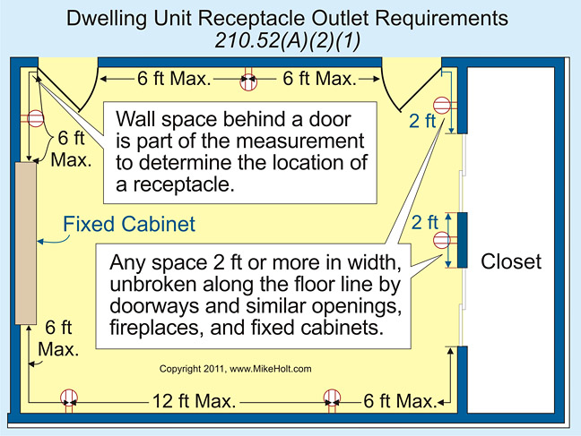

Q. What are the Code requirements for placing receptacles on “wall space” in dwelling units?
A. A receptacle outlet must be installed in every kitchen, family room, dining room, living room, sunroom, parlor, library, den, bedroom, recreation room, and similar room or area in accordance with (1), (2), and (3) [210.52(A)]. A receptacle outlet must be installed so that no point along the floor line of any wall is more than 6 ft, measured horizontally along the floor line, from a receptacle outlet  [210.52(A)(1)]. The aim of this rule is to ensure that a general-purpose receptacle is conveniently located to reduce the chance that an extension cord will be used.
Adhere to the 6-ft rule when locating receptacles on the walls of a dwelling unit.
Definition of wall space  [210.52(A)(2)]:
  • Any space 2 ft or more in width, unbroken along the floor line by doorways and similar openings, fireplaces, and fixed cabinets, as shown in the Figure above.
  • The space occupied by fixed panels in exterior walls.
  • The space occupied by fixed room dividers, such as freestanding bar-type counters or guard rails.
A new requirement added in 210.52(A)(4) specifies that receptacles installed for countertop surfaces, as required by 210.52(C), can’t be used to meet the receptacle requirements for wall space as required by 210.52(A).
