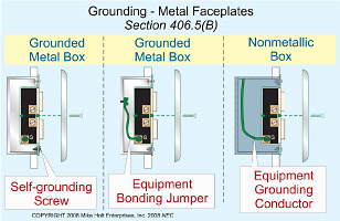

Q. Am I required to ground metal cover plates on receptacles and switches?
A. Yes, metal faceplates for receptacles and switches must be grounded. Section 406.5(B) requires that metal faceplates for receptacles must be connected to the circuit equipment grounding conductor. Although the NEC doesn’t specify how this is to be accomplished, Exception No. 1 of 517.13(B) for health care facilities permits the metal mounting screw(s) securing the faceplate to a metal outlet box or wiring device to be suitable for this purpose (Fig. 1).
For switches, dimmers, and similar control switches, the metal mounting yokes must be connected to an equipment grounding conductor of a type recognized in 250.118, whether or not a metal faceplate is installed. The metal mounting yoke is considered part of the effective ground-fault current path by one of the following means:
  1. Mounting screw. The switch is mounted with metal screws to a metal box or a metal cover connected to an equipment grounding conductor of a type recognized in 250.118 [404.9(B)]. Direct metal-to-metal contact between the device yoke of a switch and the box isn’t required.
  2. Equipment bonding conductor. An equipment grounding conductor, or equipment bonding jumper is connected to the grounding terminal of the metal mounting yoke. Exception: The metal mounting yoke of a replacement switch isn’t required to be connected to an equipment grounding conductor of a type recognized in 250.118 if the wiring to the existing switch doesn’t contain an equipment grounding conductor — and the switch faceplate is nonmetallic or the replacement switch is GFCI-protected.
