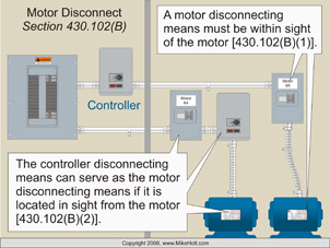

Q. What are the Code requirements for motor disconnects?
A. Each motor must be provided with a separate disconnecting means unless the controller disconnecting means meets the necessary requirements to serve the disconnect for both.
Section 430.102(B)(1) requires a disconnecting means for each motor, and it must be located in sight from the motor location and the driven machinery location. “Within Sight” is visible and not more than 50 ft from each other [Art. 100]. Or, the controller disconnecting means [430.102(A)] can serve as the disconnecting means for the motor if the disconnect is located in sight from the motor location [430.102(B)(2)], as shown in the Figure.
A motor disconnecting means isn’t required under either of the following conditions if the controller disconnecting means [430.102(A)] is capable of being locked in the open position. The provision for locking or adding a lock to the disconnecting means must be installed on or at the switch or circuit breaker and remain in place with or without the lock installed [430.102(B)(1) and (2), Ex].
  • Where locating the disconnecting means is impracticable or introduces additional or increased hazards to persons or property.
  • In industrial installations, with written safety procedures, where conditions of maintenance and supervision ensure only qualified persons will service the equipment. This should include lockout/tagout procedures.
Some additional requirements for motor disconnects include:
  • The disconnecting means for the motor controller and the motor must open all ungrounded supply conductors simultaneously, and it must be designed so that it will not close automatically [430.103].
  • The controller and motor disconnecting means must indicate whether they are in the “on” or “off” position [430.104].
  • The disconnecting means must be legibly marked to identify its intended purpose [110.22 and 408.4], and when operated vertically, the “up” position must be the “on” position [240.81 and 404.6(C)].
  • Either the controller disconnecting means or motor disconnecting means required by 430.102 must be readily accessible [430.107].
The disconnecting means for the motor controller and/or the motor must be a [430.109(A)]:
  • A listed horsepower-rated motor-circuit switch.
  • A listed molded-case circuit breaker.
  • A listed molded-case switch.
  • Listed manual motor controllers marked “Suitable as Motor Disconnect.”
For stationary motors of two horsepower or less, the disconnecting means is allowed to be a general-use AC snap switch, where the motor full-load current rating isn’t more than 80% of the ampere rating of the switch [430.109(C)].
A horsepower-rated attachment plug and receptacle having a rating not less than the motor rating is allowed as the disconnecting means for cord- and plug-connected motors [430.109(F)].
A horsepower-rated switch or circuit breaker can serve as both a controller and disconnecting means if it opens all ungrounded conductors to the motor, as required by 430.103 [430.111].
