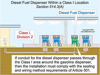

Q. How does the Code address diesel fuel dispensers as they relate to hazardous locations?
A. The hazardous Class I location requirements contained in Art. 514 only apply where a flammable liquid having a flash point below 100°F [Art. 100 Volatile Flammable Liquid] is stored, handled, or dispensed [514.3(B)]. The flash point of diesel fuel is 100°F or above; thus, the area involving diesel fuel is typically not a classified location. But if the conduit for the diesel dispenser passes through the Class I area around the gasoline dispenser, then the installation must comply with the sealing and wiring method requirements of Art. 501 ( Figure ).
