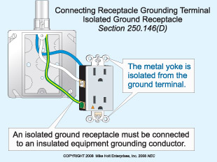

Q. What are the requirements for installing isolated ground receptacles?
A. The grounding terminal of an isolated ground receptacle must be connected to an insulated equipment-grounding conductor run with the circuit conductors [250.146(D)], as shown in the Figure. The circuit equipment-grounding conductor is permitted to terminate to the panelboard supplying the power, or it is permitted to pass through the panelboard [408.40 Ex], boxes, wireways, or other enclosures [250.148 Ex] without a connection to the enclosure — as long as it terminates at an equipment-grounding conductor terminal of the derived system or service.
