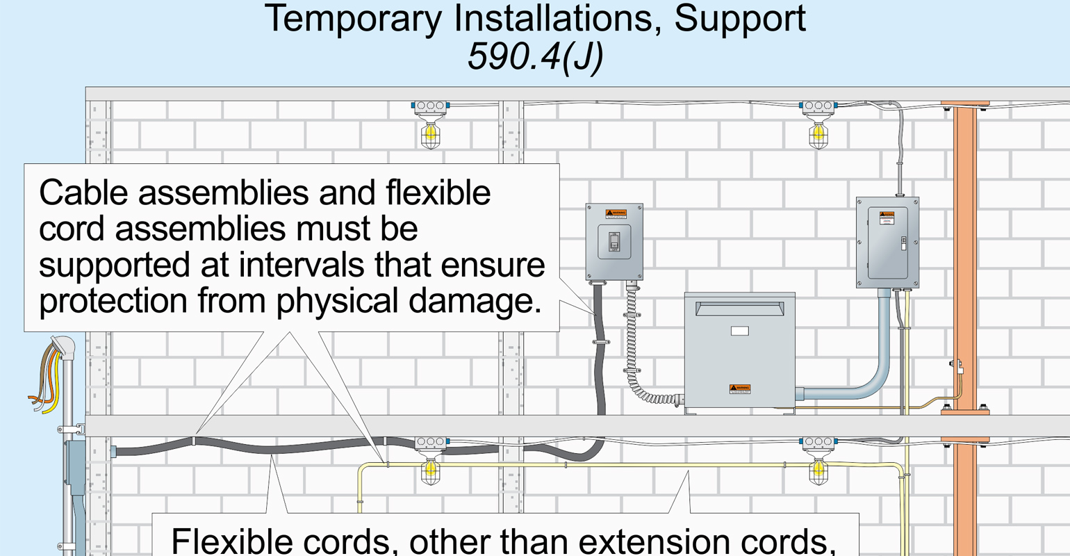

Cables and flexible cords must be protected from accidental damage and from sharp corners and projections [590.4(H)]. Protection must also be provided when cables and flexible cords pass through doorways or other pinch points.
Support is also critical. Cable assemblies and flexible cords must be supported at intervals that ensure protection from physical damage. Support must be in the form of staples, cable ties, straps, or other similar means designed not to damage the cable or flexible cord assembly. Flexible cords, other than extension cords, aren’t permitted on the floor or the ground when they’re used as branch circuits or feeders [590.4(J)] (Fig. 2).
The support requirement for temporary cables is determined by the authority having jurisdiction (AHJ), based on the jobsite conditions [590.2(B)]. How can you know what this requirement is, ahead of time? If you use good judgment rather than try to see what you can get by with, you won’t have to worry about that.
If you’re unsure how much support is enough, remember those supports don’t cost very much. Nobody gets cited for having five supports instead of the four that probably would have been sufficient.
You can’t use vegetation to support overhead branch-circuit or feeder conductors. But there is an exception. Vegetation can be used to support holiday lighting if strain-relief devices, tension take-up devices, or other means approved by the AHJ are used to prevent damage to conductors from the movement of the live vegetation [590.4(J) Ex.].
