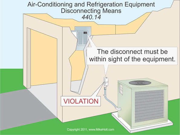

Fig. 1. Per 440.14, the disconnect must be within sight from and readily accessible to the equipment.
Locate the disconnect within sight of and readily accessible from the equipment [440.14] (Fig. 1).  Per Art. 100 “within sight” means it’s visible and not more than 50 ft away. Article 440 provides two exceptions:
