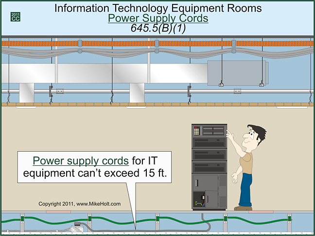

The undefined term “data processing system” is now replaced with the defined term “information technology equipment” [645.5]. It’s now clear that the 15-ft limitation of 645.5(B)(1) applies only to cord- and plug-connected interconnecting cables — not all interconnecting cables.
The 2011 NEC improves upon the listing requirements for power-supply cords and cord connectors, and a new Informational Note helps you understand what types of cords are permitted [645.5(B)(1)], as shown in Fig. 1.
