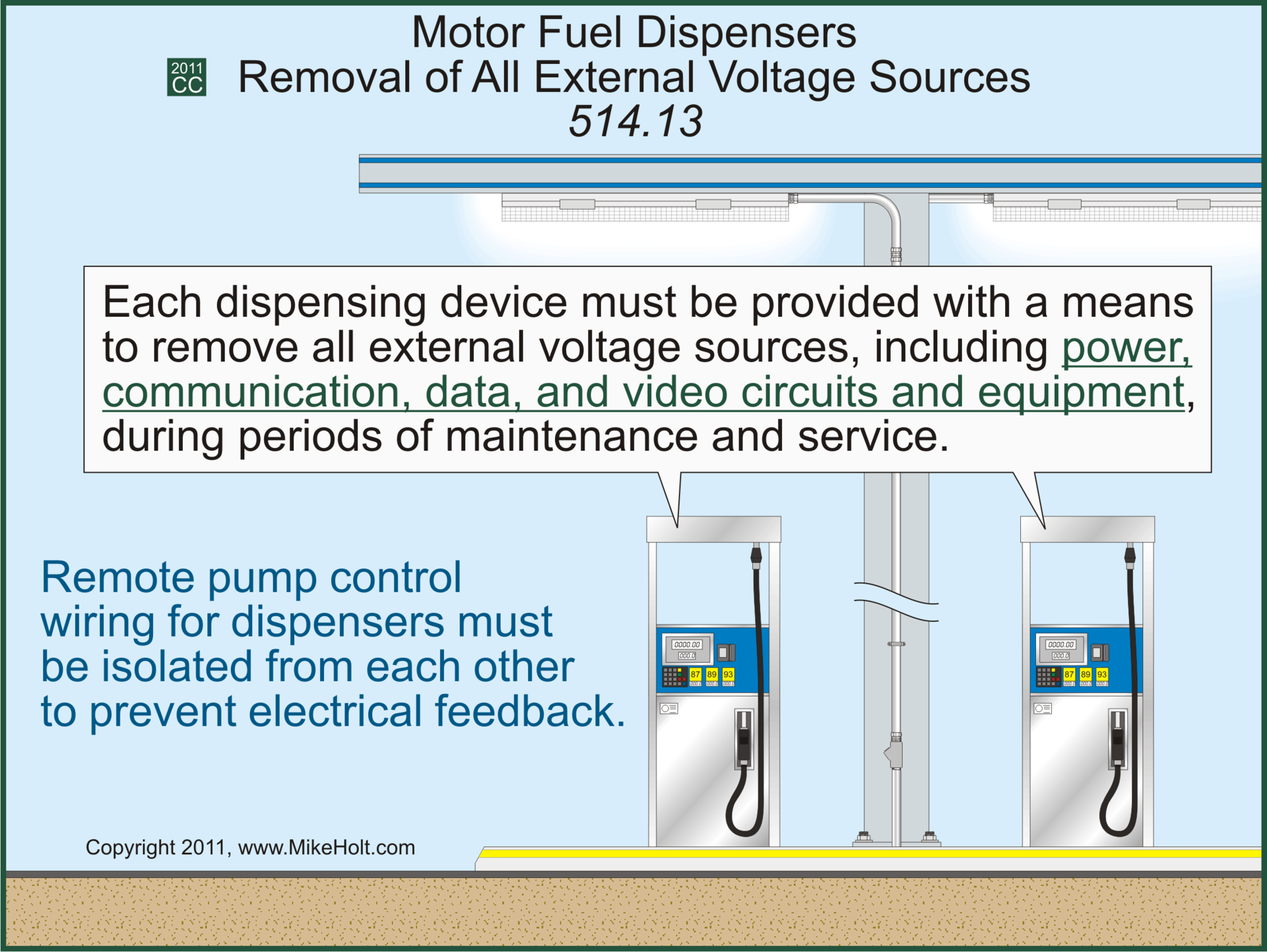

Motor Fuel Dispensing Facilities
Article 514 provides the requirements for facilities where vehicles are fueled from storage tanks. A single, large table takes up about half of Art. 514. This table doesn’t provide any electrical requirements, list any electrical specifications, or address any electrical equipment. What it does tell you is how to classify a motor fuel dispensing area based on the equipment contained therein. The rest of this Article contains specific provisions and refers to other Articles that must be applied.
Vapors from flammable and combustible liquid will ignite when heated to the correct temperature (at the correct volatile mixture). This type of ignition can occur from circuits that most users of electricity consider “safe,” such as a Class 2 power-limited circuit. While a Class 2 circuit is safe from an electrical shock and fire perspective, it’s still capable of igniting the vapors in the environment of a Class I location, such as those in fuel dispensing areas.
Section 514.11 now clarifies that all circuits to the dispensing equipment in fuel dispensing facilities must have a means to disconnect them from their power supply — regardless of the voltage. In an effort to isolate the dispensing equipment from any voltage sources present, the NEC has long required a disconnect located remotely from the dispensing devices to disconnect all circuit conductors, including the neutral, simultaneously from the source of supply [514.11]. This requirement includes low-voltage and limited-energy circuits, such as data and communications, but that fact wasn’t clear in previous editions of the Code. With the 2011 NEC, this requirement becomes quite clear: Each dispensing device shall be provided with a means to remove all external voltage sources, including power, communications, data, and video circuits and including feedback, during periods of maintenance and service of the dispensing equipment [514.13], as shown in Fig. 1 (click here to see Fig. 1).
