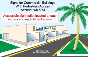

If a tenant location is accessible to pedestrians, install at least one sign outlet at each entrance (service hallways and corridors don't count as entrances) [600.5]. Dedicate an individual branch circuit (rated at least 20A) for this purpose. The circuit can serve multiple sign outlets but no other load (Fig. 1).
