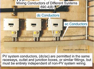

You can install conductors for direct current (DC) and AC equipment in the same raceways, outlet and junction boxes, or similar fittings with each other, but keep them independent of all other (non-PV system) wiring [690.4(B)] (Fig.1).
Identify PV system conductors by separate color coding, marking tape, tagging, or other approved means. Identification of different systems isn’t required where the identification of the conductors is evident by spacing or arrangement. The following must be identified at termination, connection, and splice points:
