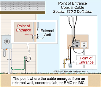

Perhaps the most important definition in Art. 820 is “point of entrance.” Knowing this is critical to meeting various grounding requirements, such as those in 820.33 and 820.40. The point of entrance is where the cable emerges from an external wall or a concrete floor slab, or from a rigid metal conduit or intermediate metal conduit grounded to an electrode according to the requirements of 820.40(B) (Fig. 1). You must also know the point of entrance to determine the length of unlisted cable inside a building (820.50, Exception No. 3).
