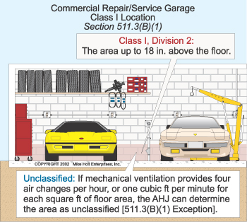

Elevations. Thinking of an area in terms of the plan view in a drawing is two-dimensional. Classifications include the third dimension of height. Thus, the elevation of a given volume of space is a critical factor in its classification.
The service and repair area up to 18 in. above the floor is classified as Class I, Division 2 (Fig. 1). Where compressed natural gas (CNG) vehicles are repaired or stored, the area within 18 in. of the ceiling is also classified as Class I, Division 2. However, if mechanical ventilation provides a minimum of four air changes per hour, the authority having jurisdiction (AHJ) can declare the area nonclassified.

Fig. 3 illustrates the stipulation in 511.3(B)(4) that areas adjacent to classified locations, such as stock rooms, switchboard rooms, and other similar locations, aren't classified if they're mechanically ventilated at a rate of four or more air changes per hour or when the adjacent area is effectively cut off by walls or partitions. The AHJ may declare areas adjacent to classified locations unclassified for reasons of ventilation, air pressure differentials, or physical spacing.
