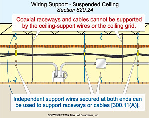

You must securely fasten raceways that contain coaxial cables in place. Don't use ceiling-support wires or the ceiling grid to support raceways or cables (Fig. 1). You can, however, support raceways and cables with independent support wires attached to the suspended ceiling per 300.11(A).
