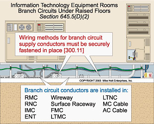

You can install receptacles and run power cables, communications cables, connecting cables, and interconnecting cables under raised floors — but only if the installation meets these conditions:
  • Construction
    The raised floor must be of suitable construction, and the area under the floor must be accessible.
  • Wiring methods
    Branch-circuit wiring methods must be securely fastened in place per 300.11.
  • Raceways
    You must also install the branch circuits for receptacles or hard wired equipment in one of the following kinds of raceway: rigid metal conduit, rigid nonmetallic conduit, intermediate metal conduit, electrical metallic tubing, electrical nonmetallic tubing, metal wireway, nonmetallic wireway, surface metal raceway with metal cover, nonmetallic surface raceway, flexible metal conduit, liquidtight flexible metal conduit, liquidtight flexible nonmetallic conduit, Type MI cable, Type MC cable, or Type AC cable (Fig. 1 above).
    You can use nonmetallic raceways within the raised floor area because this space is neither subject to physical damage nor required to comply with the environmental airspace requirements of 300.22(C). Although it seems strange to install nonmetallic raceways in an air handling space, it is not prohibited because the air does not mix with the rest of the building. When you think about it, if there is a fire inside of the IT room the noxious gases emitted by nonmetallic wiring methods will only affect the IT room itself, which is not occupied by people on a regular basis [645.4(4)].
