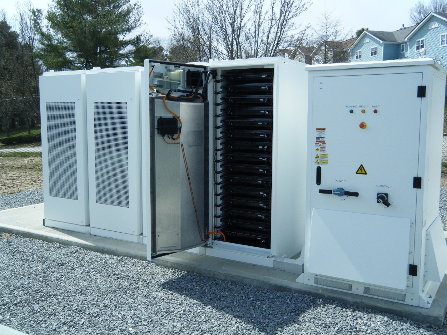

Here's an example of a complete energy storage system.

In this installation, the inverter charge controller is separate from the storage system.
