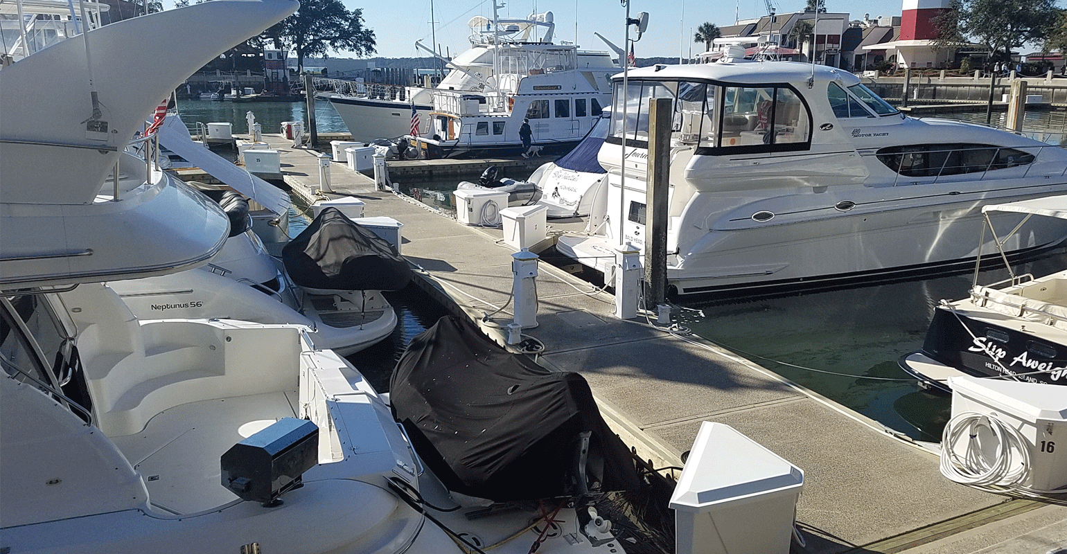

This GFP requirement was initially proposed because of numerous fatalities occurring in and around marinas due to human contact with stray currents in contact with the water (Photo 1). Part of the substantiation noted several deaths due to drowning where the victims lost function of their limbs and the ability to react or swim — now commonly known as electric shock drowning (ESD). Although this 2011 NEC requirement almost certainly provided some degree of protection, there were still issues that needed to be addressed if the concern was with protection of personnel.
For the 2017 NEC, this maximum 100mA capacity was reduced to 30mA. This 30mA ground-fault limit was consistent with that recommended in a report titled, “Assessment of Hazardous Voltage/Current in Marinas, Boatyards and Floating Buildings,” which was commissioned by NFPA’s Fire Protection Research Foundation and conducted by the American Boat and Yacht Council (ABYC) Foundation, Inc. This report stated in part:
“ABYC Standards recommend a device that interrupts the source of power feeding a fault within 100 msec from the moment stray current exceeds 30mA. While 30mA through the body is more than enough to kill a swimmer (above the ‘let-go’ threshold established for a Class A GFCI device), it is not sufficient to assume that all the 30mA leaking into the water will actually go through the swimmer. Rather, U. S. Coast Guard studies have shown that due to hemispherical ‘spreading’ of the electric field, only a portion of the leakage current will go thru the swimmer. The main exception to this occurs when the swimmer comes into direct contact with the voltage source itself, for example by grabbing a metallic ladder that has become energized. 30mA represents an acceptable level that ABYC expects to prevent most electric shock drowning (ESD) incidents while remaining practical enough to minimize unnecessary tripping.” The substantiation for this reduction to 30mA went on to state, “It should also be noted that ABYC standards, since Dec. 31, 2012, have required 30mA equipment leakage circuit interrupters (ELCI) on watercraft. While boats are not subject to NEC requirements, boats are connected to electrical branch circuits that are.”
Once this 30mA maximum GFP requirement went into practical application, the part about “remaining practical enough to minimize unnecessary tripping” proved to be unreliable. Through a cumulative effect, it did not take but a few boats leaking current into the water around a marina before the 30mA level was exceeded. This 30mA maximum required GFP requirement virtually shut down new construction of marinas and boatyards in jurisdictions enforcing the 2017 NEC. The marina industry desperately needed some relief from this 30mA maximum GFP requirement.
