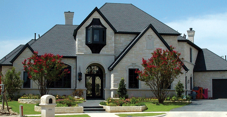

Let’s begin with a review of some common installation methods that are used to provide power to larger single-family dwellings. All references are based on the 2017 edition of the NEC with a few comments related to changes being proposed for the 2020 NEC.
As with any building that power is supplied to, our reference should be Art. 220. This is where the requirements for load calculations for the specified installation can be found. However, for the discussion that follows, we will assume that the calculations have already been performed, and it is necessary to install a 400A service, or feeder, to the dwelling.
In these larger, more expensive dwellings, it’s common that they are not fed with overhead service drops or overhead service conductors. Instead, they are typically fed through an underground feed. It is common to have a 400A (actually 320A) meter socket mounted on a pedestal at the outer edge of the property. Then, two sets of conductors are routed underground through the basement wall directly into the back of two 200A main breaker panelboards.
The first requirement in Art. 230 you must follow is the permissive language found in Sec. 230.2, which states, “For the purpose of 230.40, Exception No. 2 only, underground sets of conductors, 1/0 AWG and larger, running to the same location and connected together at their supply end but not connected together at their load end shall be considered to be supplying one service.”
When looking at Exception No. 2 in Sec. 230.40, it references two to six disconnecting means in separate enclosures and grouped in one location. As you can see so far, we are fine with the installation described above. It meets Code.
Let’s look a little deeper into Art. 230 at some other requirements. Section 230.70(A)(1) mandates that the disconnect(s) be installed in a readily accessible location either inside or outside the building or structure; inside must be nearest the point of entrance. In our design noted above, the panelboards located on the interior basement wall are acceptable. Section 230.71(A) permits up to six switches or circuit breakers to serve as the service disconnecting means. Section 230.72(A) requires the disconnecting means to be grouped in one location (Fig 1).
Let’s look at a similar but different installation. In this example, we still have two 200A panelboards attached to the interior basement wall, which are fed from two different sets of conductors. However, instead of only having a meter socket at the outer edge of the property, we install a meter with two 200A circuit breakers. These circuit breakers now become the service disconnect, and the conductors from this equipment to the two panelboards that we installed in the basement are now considered feeder conductors. In evaluating this installation, we need to refer to Art. 225 for outside branch circuits and feeders. In evaluating this arrangement, the main concern is Sec. 225.30, which reads as follows: “A building or other structure that is served by a branch circuit or feeder on the load side of a service disconnecting means shall be supplied by only one feeder or branch circuit unless permitted in 225.30(A) through (E).”
Here’s the dilemma! We can supply two panelboards as service equipment directly through the basement wall, but when we place overcurrent protection ahead of the conductors, it is no longer permitted (Fig. 2).
As part of the 2020 Code change cycle, Code-Making Panel No. 10 accepted a proposed change that reads:
“225.30(B) Common Supply Equipment. Where feeder conductors originate in the same panelboard, switchboard, or other distribution equipment, and each feeder terminates in a single disconnecting means, not more than six feeders shall be permitted. Where more than one feeder is installed in accordance with this section, all feeder disconnects in the building or structure supplied shall be grouped in the same location, and the requirements of 225.33 shall not apply. Each disconnect shall be marked to indicate the load served.”
