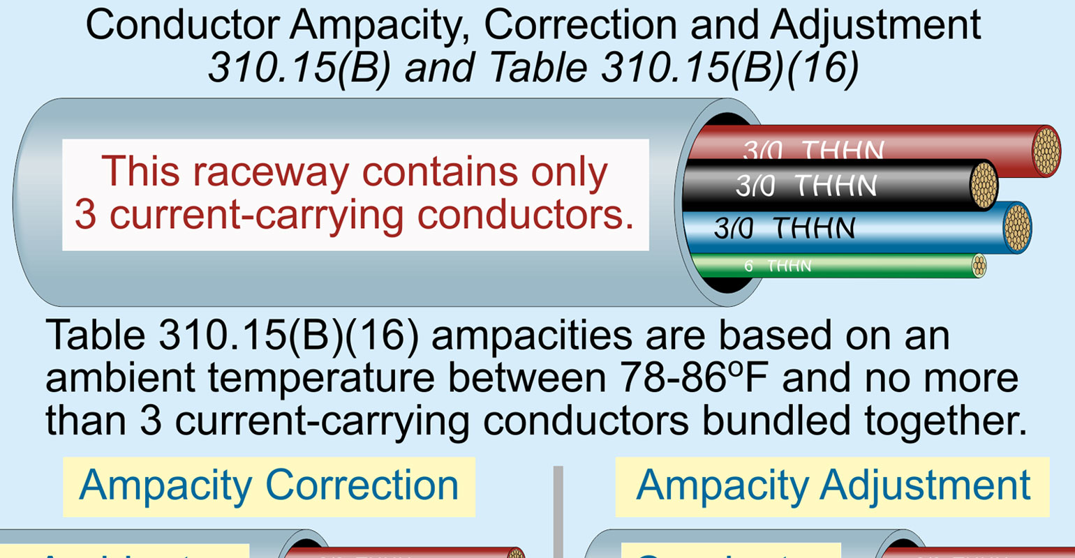

The allowable conductor ampacities listed in Table 310.15(B)(16) are based on conditions where the ambient temperature is between 78°F and 86°F, and no more than three current-carrying conductors are bundled together in a raceway, cable, or directly buried in earth.
The temperature correction [310.15(B)(2)(a)] and adjustment factors [310.15(B)(3)(a)] apply to the conductor ampacity, based on the temperature rating of the conductor insulation per Table 310.15(B)(16) (Fig. 2).
When conductors are installed in an ambient temperature other than 78°F to 86°F, then the ampacities listed in Table 310.15(B)(16) must be corrected using the multipliers listed in Table 310.15(B)(2)(a).
Where four or more current-carrying power conductors are within a raceway longer than 24 in. [310.15(B)(3)(a)], or where cables are bundled for a length longer than 24 in., the ampacity of each conductor must be adjusted per Table 310.15(B)(3)(a), as shown in Fig. 3.
