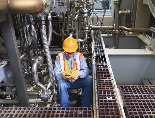

Working spaces
For industrial construction, the working space issue has special implications. Maintenance people must deal with walls and switchgear cabinets already in place. Construction people can design out problems maintenance people otherwise must deal with. Don’t think in terms of “three feet” but in terms of what will be adequate for operating and servicing the equipment [110.26].
