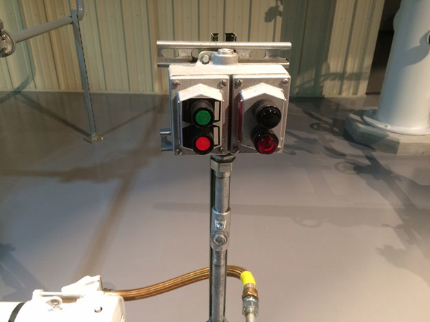

The Photo (courtesy of Eaton Crouse Hinds) shows a typical hazardous area control station with a conduit seal below.
