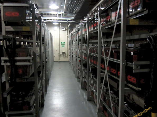

Article 480 provides the electrical installation requirements for all stationary installations of electrical storage batteries (Photo). If you have batteries for photovoltaic (PV) systems, the additional requirements of Art. 690, Part VIII apply. But covering a battery system from square one to end of life requires far more knowledge than what is in Art. 480 (see SIDEBAR: Beyond Article 480).

This battery room contains several battery racks, and it illustrates several best practices. Despite the large number of jars, there are only three tiers — and they are widely spaced. Notice also how clean everything is; not only is there no corrosion, there’s no grime or dirt of any kind (Photo provided by the 7x24 Exchange, Midwest Chapter).

There’s nothing in these subsections a good battery system designer wouldn’t do anyhow, and there’s plenty they don’t say. For example, they don’t address important issues with rack design. There’s no NEC requirement preventing you from installing a 5-tier rack with 4 in. between tiers. But try maintaining the cells and interconnections in such a design. The heat issues with it are also formidable, and good luck determining the correct float voltage. One thing you don’t do is try to get something “free” in terms of square footage, yet the effort to do so is a cause of poorly performing battery installations.
