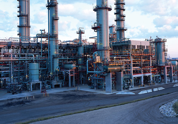

Article 501 provides the requirements for Class I locations, such as the refinery shown in Photo 1. In the May issue, we described the Division system outlined in the NEC, which further breaks down the class. If the ignitable material is normally present (in sufficient quantities to present a hazard), then it’s a Div. 1 location. Less stringent requirements apply for a Div. 2 location, because ignitables are present only in abnormal circumstances.

Photo 1. Petro-Canada’s refinery conversion project in Edmonton, Alberta, is an example of a Class I location. The KBR engineers that worked on this project had to maneuver their way through significant Art. 501 compliance issues.
