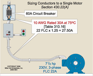

Fig. 1. Conductors for a single motor must have an ampacity of not less than 125% of the motor full-load current rating.

Branch-circuit conductor size. Branch-circuit conductors to a single motor must have an ampacity of not less than 125% of the FLC as listed in Tables 430.247 through 430.250 [430.6(A)(1), 430.22(A)].
When selecting motor current from one of these tables, note that the last sentence above each table allows you to use the ampacity columns for a range of system voltages without any adjustment. Select the conductor size from Table 310.16 according to the terminal temperature rating (60ºC or 75ºC) of the equipment [110.14(C)].
THHN/THWN is a common conductor insulation type that can be used in a dry location at the THHN 90ºC ampacity, or in a wet location at the 75ºC ampacity for the THWN insulation type. Regardless of the conductor insulation type, size the conductor per 110.14(C).
In 110.14(C)(1)(a), we read that equipment terminals are rated 60ºC for equipment rated 100A or less (unless marked 75ºC). Today, most equipment terminals are rated at 75ºC. Look for that specification, so you can use the 75ºC column if your conductors are also rated for 75ºC. If this is the case, you may save considerable money on your project. If you can’t find that specification, use the rules of 110.14(C).
Test your knowledge by answering this question: What size branch-circuit conductors are required for a 7½-hp, 3-phase, 230V motor (Fig. 1 on page 76)?
The motor FLC from Table 430.248 is 22A. The conductor is sized no less than 125% of motor FLC: 22A 3 1.25 = 27.50A. As per Table 310.16, a 10 AWG conductor is rated 30A at 75ºC.
