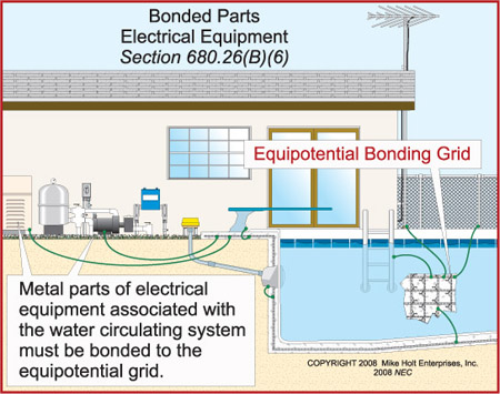

(3) Metallic Components. Metallic parts of the pool, outdoor spa, or outdoor hot tub structure shall be bonded to the equipotential grid.
(4) Underwater Metal Forming Shells. Metal forming shells and mounting brackets for luminaires and speakers shall be bonded to the equipotential grid.
(5) Metal Fittings. Metal fittings sized 4 in. and larger that penetrate into the pool, outdoor spa, or outdoor hot tub structure, such as ladders and handrails shall be bonded to the equipotential grid.
(6) Electrical Equipment. Metal parts of electrical equipment associated with the pool, outdoor spa, or outdoor hot tub water circulating system, such as water heaters, pump motors, and metal parts of pool covers shall be bonded to the equipotential grid. (see Figure)
Exception: Metal parts of listed equipment incorporating an approved system of double insulation is not required to be bonded to the equipotential grid.

(7) Metal Wiring Methods and Equipment. Metal-sheathed cables and raceways, metal piping, and all fixed metal parts shall be bonded to the equipotential grid.
