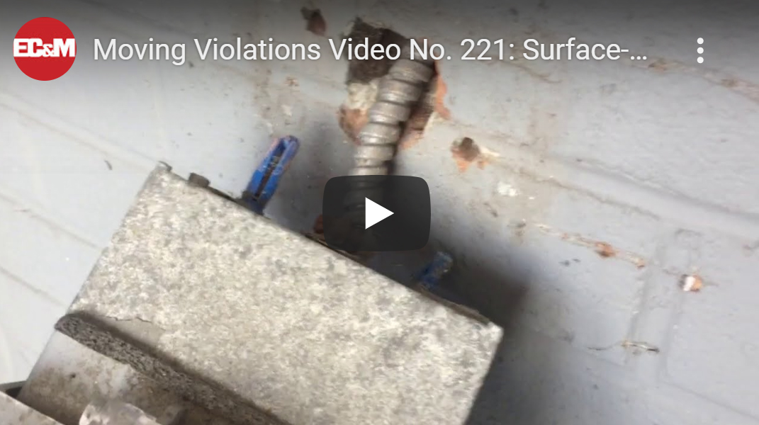

In this episode, Russ finds a dangling box that’s delivering power to a vending machine.
In this episode, Russ finds a dangling box that’s delivering power to a vending machine. Section 314.23(A) requires surface-mounted boxes to be securely fastened in place. As you’ll see in this video, plastic anchors just didn’t do the job.
