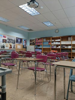

Over the past year, lighting team members from Pacific Northwest National Laboratory (PNNL) have been walking through K-12 school corridors and classrooms to learn more about the day-to-day facility operations of schools. The scene is familiar: in the background, the lively voices of children playing and learning. Colorful graphics line the walls with encouraging messages and the latest artwork — a welcome contrast to the clean, sleek environment of many offices.
The lighting itself recalls our many days in school: fluorescent troffers and wraparounds, with the occasional pendant. While most visitors look at the inspiring imagery — not the luminaires — we are walking the halls to understand why fluorescent lighting is still so prevalent in schools across America.
